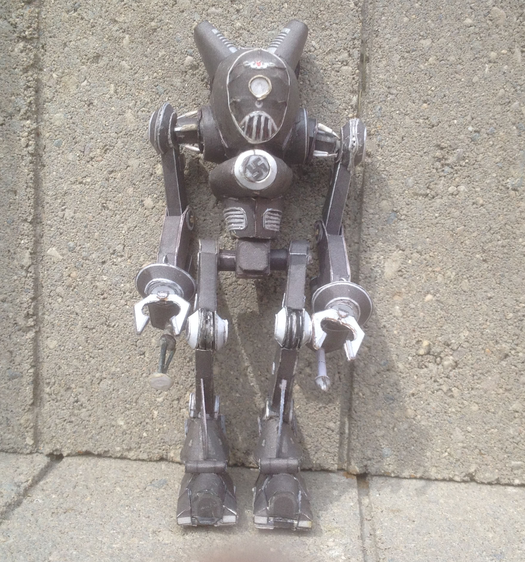

Sooo...anyway I got this done a few months back. I was going to build a diorama, but just didn't have the time. I'm posting it with some old blurry build pics and some finished pics. Also, with the kind permission of the designer, I am posting a few comic panels to show the inspiration.
You can build it either static or pose-able. I chose the latter, not realizing that the designer had forgotten to make the ankles pose-able as well. The end result was a figure that is like one of those tap dancing dolls that you place on a piece of wood and make the arms and legs swing. No biggie, but I would have modified the design if I had not realized the problem so late in the process.
Anyway, to the overall build: clear instructions and assembly drawings. Pretty straightforward. I noticed the paper model was going to glaze over some of the detailing of the CG model, so I started with printing two copies so I could add the raised surface detail.
The list of mods:
I added the raised surface detail to the torso, including the eagle, grills, swastika, electric shock warning (on back), ring around the optic lens, built up the tread on the feet and built up the claws as well.
I cut the venting hole son the the dual radiators (but gave up recessing the gray areas after several tries - too fiddly) and the cooler on the electric gun (left arm).
I replaced all smaller hydraulic pistons with q-tip stems (rolled, paper ones, of course) and the hoses off the dual radiators as well. I also replaced the electric gun tube with a leftover from another project and used paperclip sections for the chain gun "arms."
also replaced the electric gun tube with a leftover from another project and used thin paper strips reinforced with superglue for the chain gun "arms."
I created mini rolled pistons for the shoulder joints as there were none for the model, but clearly shown on the CG model and the comic reference pages the designer sent. I also modified the shoulder cap to more closely mimic the CG/comic design as the center is supposed to be recessed and not flat.

Nice build even if i totally disagree with the swastika i do not know if you really know whatthis sign mean or if it just for you a "deco" as an other , maybe should be replace by a hello kitty face or just nothing

I am well aware of the history of the swastika. This model was not my design and it was created by the designer for a comic that ran in ABC Magazine; but was cancelled before the end of the story run. It was supposed to be a sentinel on an abandoned Nazi Moon Base, so the context of the swastika is appropriate (and Hello Kitty is not).
It concerns me when society tries to whitewash history, because then you have one or more generations growing up without the knowledge of why something is considered inappropriate, and therefore; becoming more susceptible to someone who comes along espousing views and symbols that were considered evil or inappropriate. Better to be an adult and answer questions of the youth rather than hide it from them.
